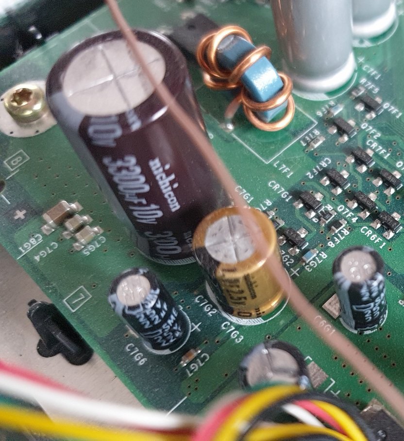

24 minutes ago, yoyixms said:

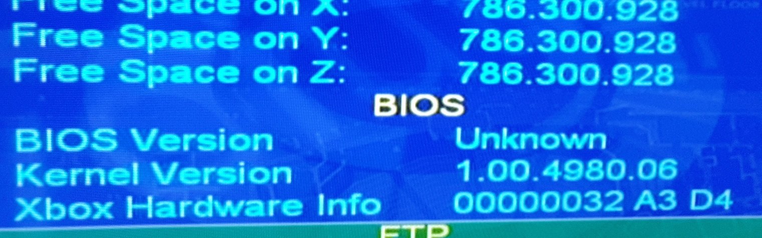

I was reading about this capacitor time bomb. Seems that my Xbox is a 1.5 (not really sure yet) means I have to remove it right?
If your Xbox is a version 1.6 there is no need at this stage to worry about removing the clock cap but the versions 1.0 -1.4 it should be removed ASAP.
You might have noticed I did not mention a 1.5 because it's the same as unicorn poop(non existent).

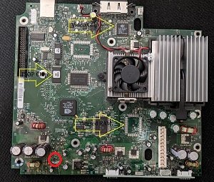

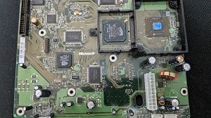

Is there any way to know it exactly with that information? I'm not sure yet...
A version 1.0 fas a small fan on the small heat sink next to the main heat sink and a 12 pin power connector
A version 1.1 has does not have the small fan and still has the 12 pin power connector
The version 1.2-1.3  has a 20 pin power connector and a version 1.4 has the same but the video chip near the AV port is made by Focus.
Lastly the version 1.6 has a 20 pin power connector but the main board is missing the extra ram locations and the TSOP chip is also not there.
The red circle (bottom left) is the clock cap location on a version 1.0 -1.4 that needs to be removed
A version 1.0 board
A version 1.6 board

Thank you for the images! I will try to remove it this weekend and then give you all an update whether it survived or not ;)

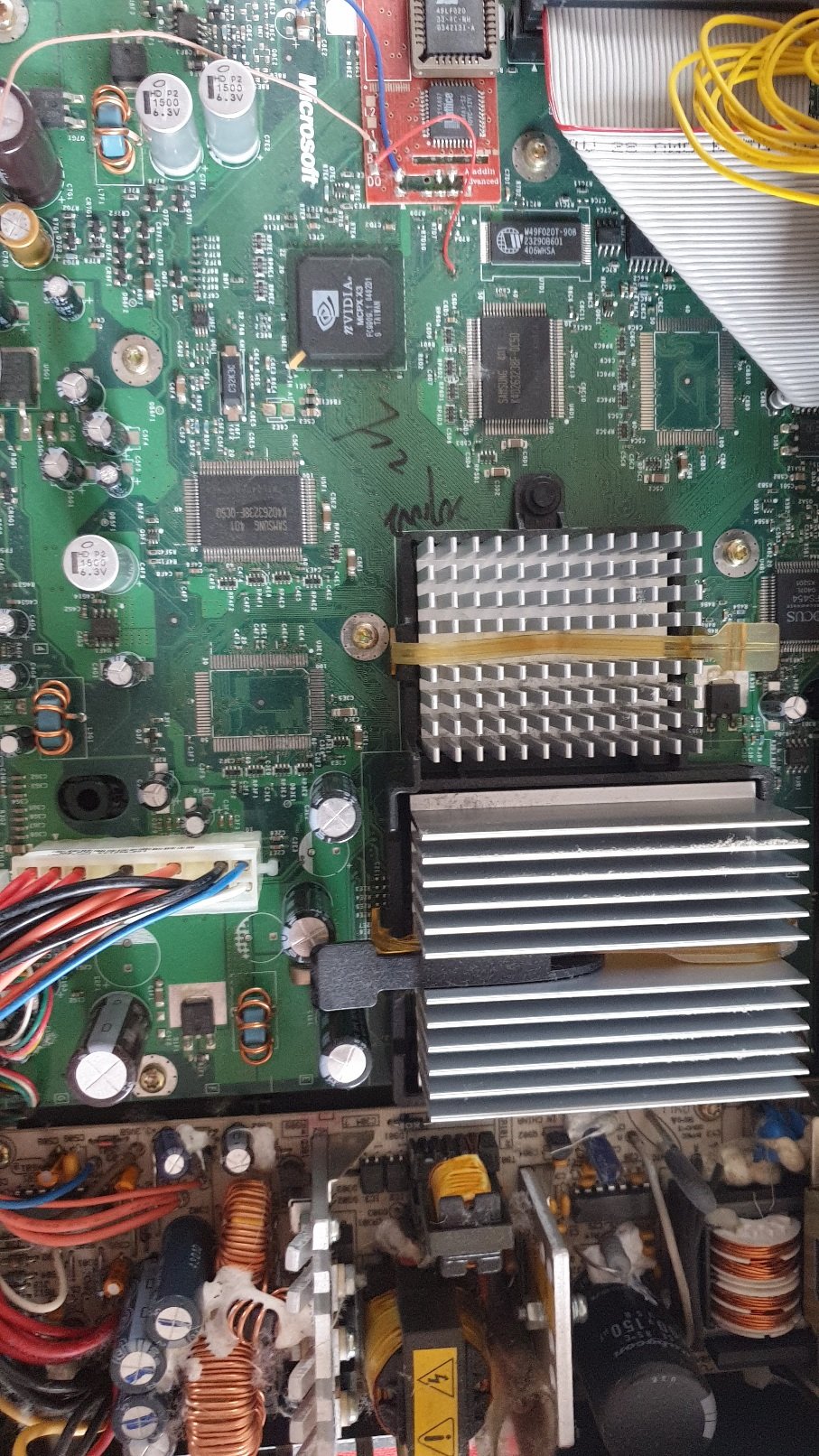

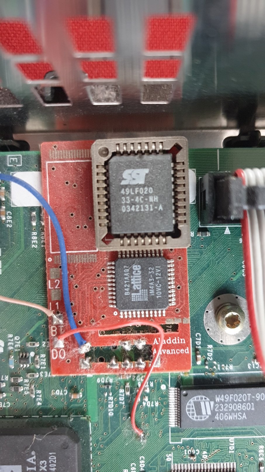

Yes the golden capacitor is the clock cap and it is a better quality one but i would still remove it as it won't be long before it starts to leak.
The board is a version 1.4 and the modchip is a aladdin.
I would reflash it with the EvoxM8plus.67.bin or you could also use the iND5004.67.bin both support up to a 3tb hard drive.
I am not sure what the blue wire is for, I am thinking that due to a bad solder joint is going to a ground somewhere.

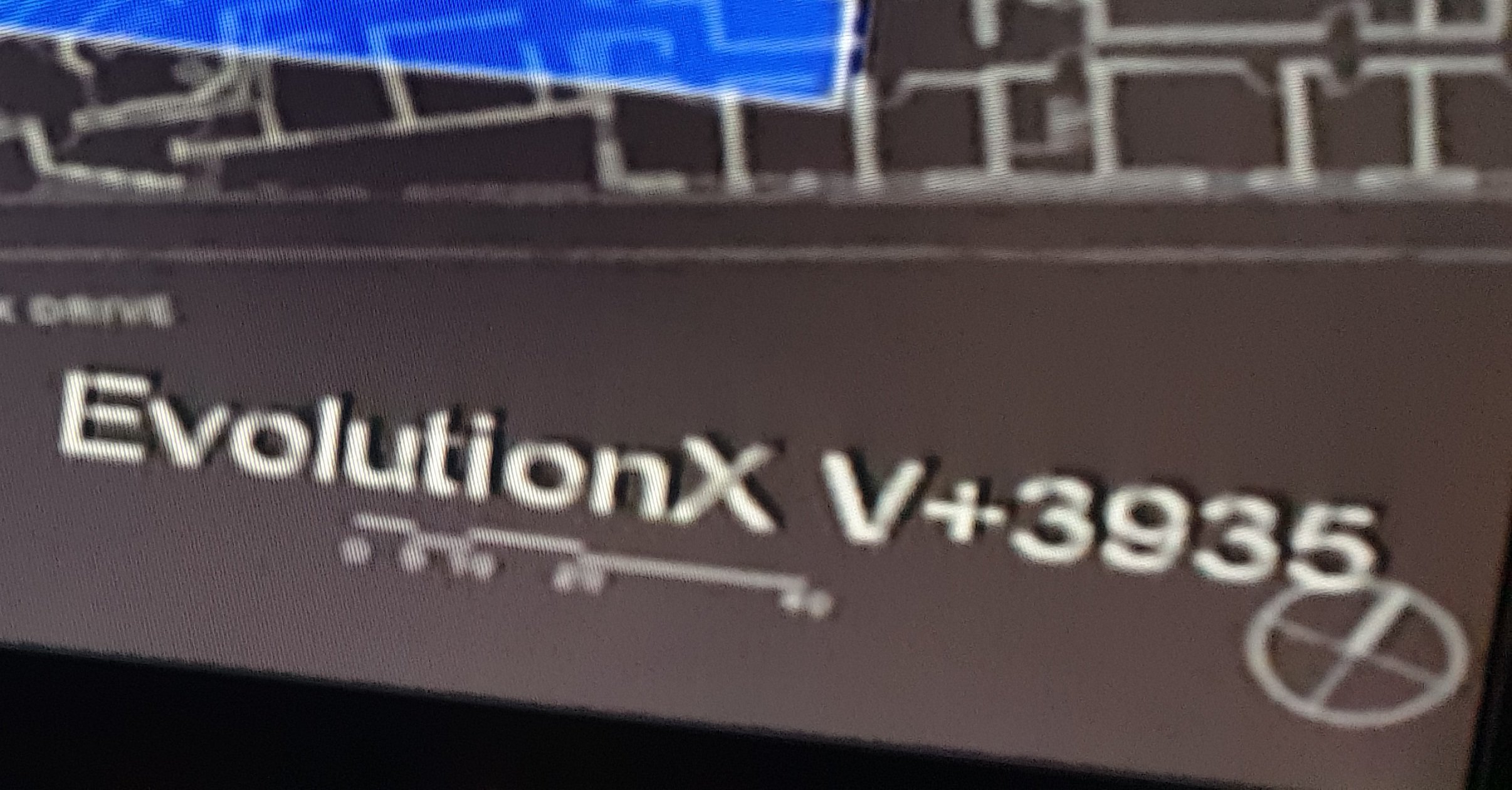

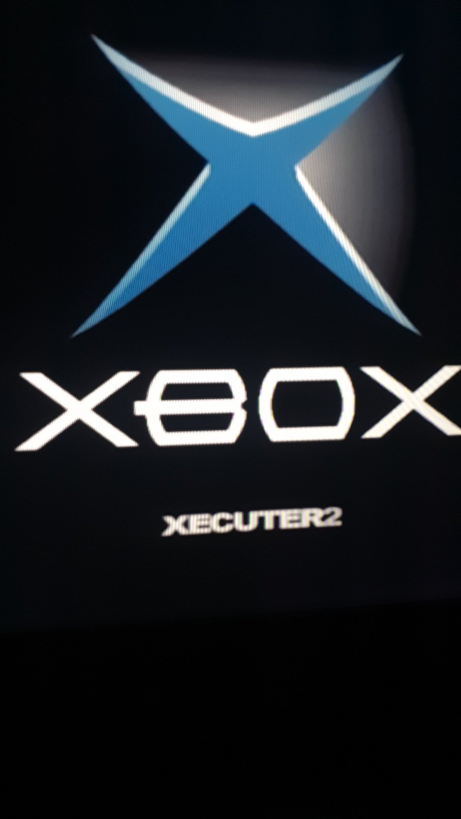

So I flashed iND5004. Seens to be working because the boot screen changed and the front button light when booting (before it was red, now green). Other than that I do not see any difference :) . Is there anyhing else would you recommend me to change?. Another question: what does it mean that the HDD is locked?
