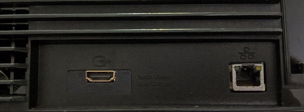

Fit a wii2hdmi or N64 internal HDMI   010.jpg.486b12395779d542c2af73e01a602591.jpg  IMG_20200612_194220.jpg.8dde1b0501f8d4f0158562f4faaaecfd.jpg

I find the Wii2HDMI works great. I should look into replacing the existing connector with it though,,,
