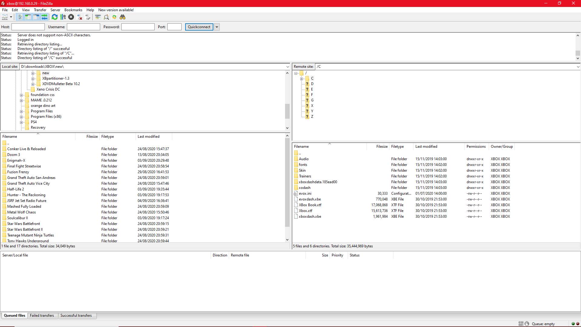

You don’t need a config file for ind-bios to work just to set your preferences. Do you have a m$ dash xbe in your c partition? Post a pic of the root of your c partition.

I copied the indbios.cfg over last night but it does not seem to make any difference to the system booting.
So I have opened it up just to have a look what in in there and noted the following 3 lines:
DASH1=\Device\Harddisk0\Partition2\evoxdash.xbe
DASH2=\Device\Harddisk0\Partition2\nexgen.xbe
DASH3=\Device\Harddisk0\Partition2\avalaunch.xbe
Obv I dont dash 2 or 3, But I was wondering if I should change dash 1 to be partition 1 instead of 2? C drive is partition 1 correct?
Could I delete dash 2 and 3 to save confusion? Or maybe even set dash 2 to the default MS dash?
Partition 2 is C drive and 1 is E drive.
Don't delete any drives
E drive is also the game save drive.
When installing XBMC or XBMC 4Gamers the normal place is E drive
And I change the Dash list to
DASH1=\Device\Harddisk0\Partition1\xbmc\default.xbe
DASH2=\Device\Harddisk0\Partition2\evoxdash.xbe
This way it boots direct to XBMC4Gamers and if that's not there then evoxdash which is normally a shortcut to a different dash.
