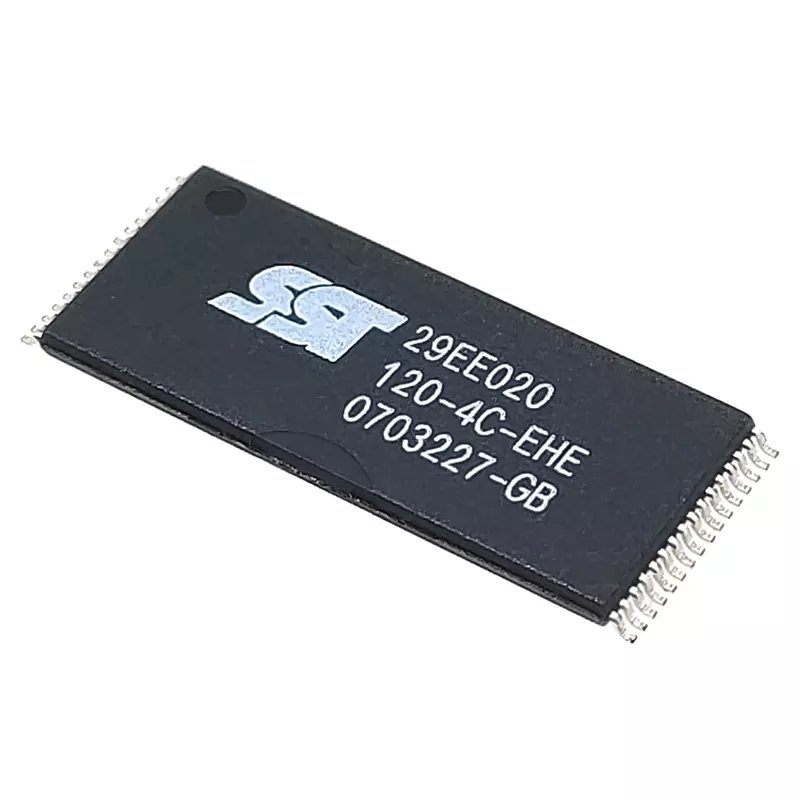

sweetdarkdestiny Posted October 4, 2022 Report Share Posted October 4, 2022 2 hours ago, Slavik916 said: Как его теперь перепрошить? Паять и делать программатор? или заменить на другой цоп32? или есть какой-то способ? Может какой-то контакт, защищающий от записи, отпаять? Для апгрейда оперативки делал цоп на 1.4 с атмелом at49f002a. Установил xblast, увеличил оперативную память и хотел перепрошить на ind bios, но xblast отказывается прошиваться ни с hdd c /bios, ни через netflash. что делать теперь подскажите. Я знаю, что у атмела есть контакт, защищающий от записи, но как тогда он прошился на xblast? Помощь https://sl.aliexpress.ru/p?key=J9N0sihttps://sl.aliexpress.ru/p?key=ZeN0FA Well.... You need something like a tl866ii plus with a TSOP32 adapter. With it you can programm a TSOP. You can also programm your Atmel chip with it (It's supportet by this programmer). Quote Link to comment Share on other sites More sharing options...
Slavik916 Posted October 4, 2022 Report Share Posted October 4, 2022 1 hour ago, sweetdarkdestiny said: Well.... You need something like a tl866ii plus with a TSOP32 adapter. With it you can programm a TSOP. You can also programm your Atmel chip with it (It's supportet by this programmer). Yes. I have a tl866 2 plus programmer, I'm waiting for an adapter. and nand pogrammer can not be soldered to lpc and remake it from a computer? like on x360 for example? Quote Link to comment Share on other sites More sharing options...
Slavik916 Posted October 4, 2022 Report Share Posted October 4, 2022 well, if anything ... this micro is the same as atmel https://www.datasheetq.com/SST29EE020-120-4C-EH-doc-SST changed and you can do tsop at least a few times Quote Link to comment Share on other sites More sharing options...

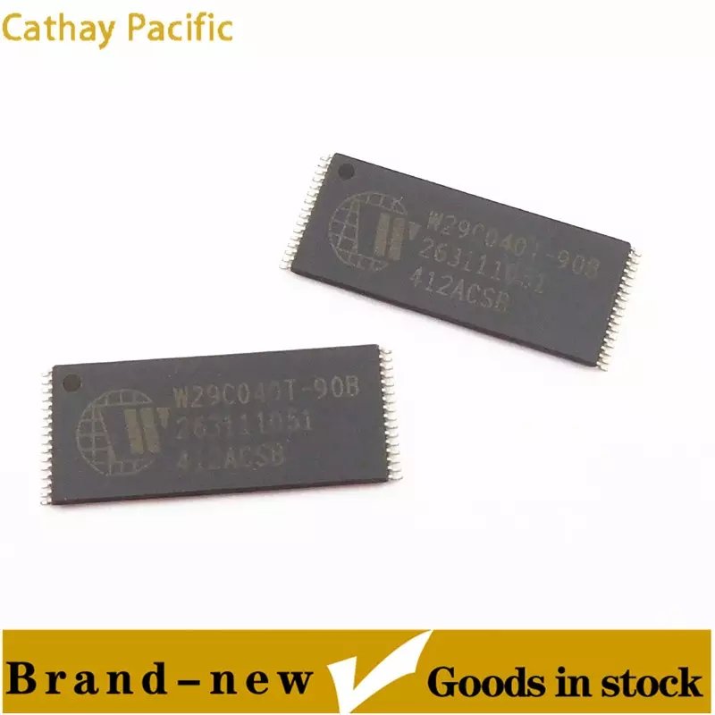

sweetdarkdestiny Posted October 4, 2022 Report Share Posted October 4, 2022 19 minutes ago, Slavik916 said: and nand pogrammer can not be soldered to lpc and remake it from a computer? like on x360 for example? As far as I know you can't do that. How ever, the SST and Atmel are interchangeable. But I would not use the Winbond. Quote Link to comment Share on other sites More sharing options...
