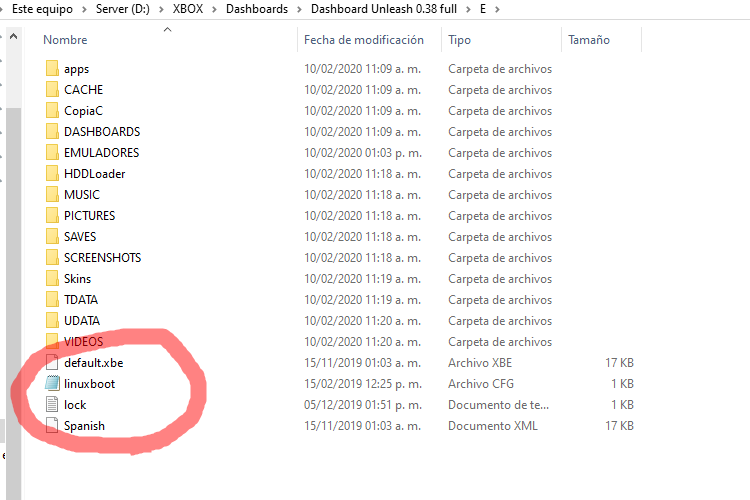

Hello again,
I was able using a raspberry-pi to dump my eeprom (now it is saved on 2 different computers in case of).
After burning a xboxhdm including this eeprom.bin I was able to unlock the hdd.
Unfortunately after changing the content to restore the original content (I can use a linux terminal and mounted manually the partition) I cannot lock the drive again (confirmed by error 05).
I'm pretty sure it is because it an old Compaq PC (with PATA connection) but I'm pretty sure I have another PC with PATA connection.
So I 'm now going to grab this PC to try to lock again the drive.
Again thanks for all your support.
Hello again,
Quick update : I was able to lock again the HDD using the other computer and I am now able to boot back to the UnleashX dashboard.
My only concern is that it tries to load several time before succeeding (it flash then black screen some times before staying on my screen).
I will now try to create another HDD for my xbox using xboxhdm and my working hdd as a base.
