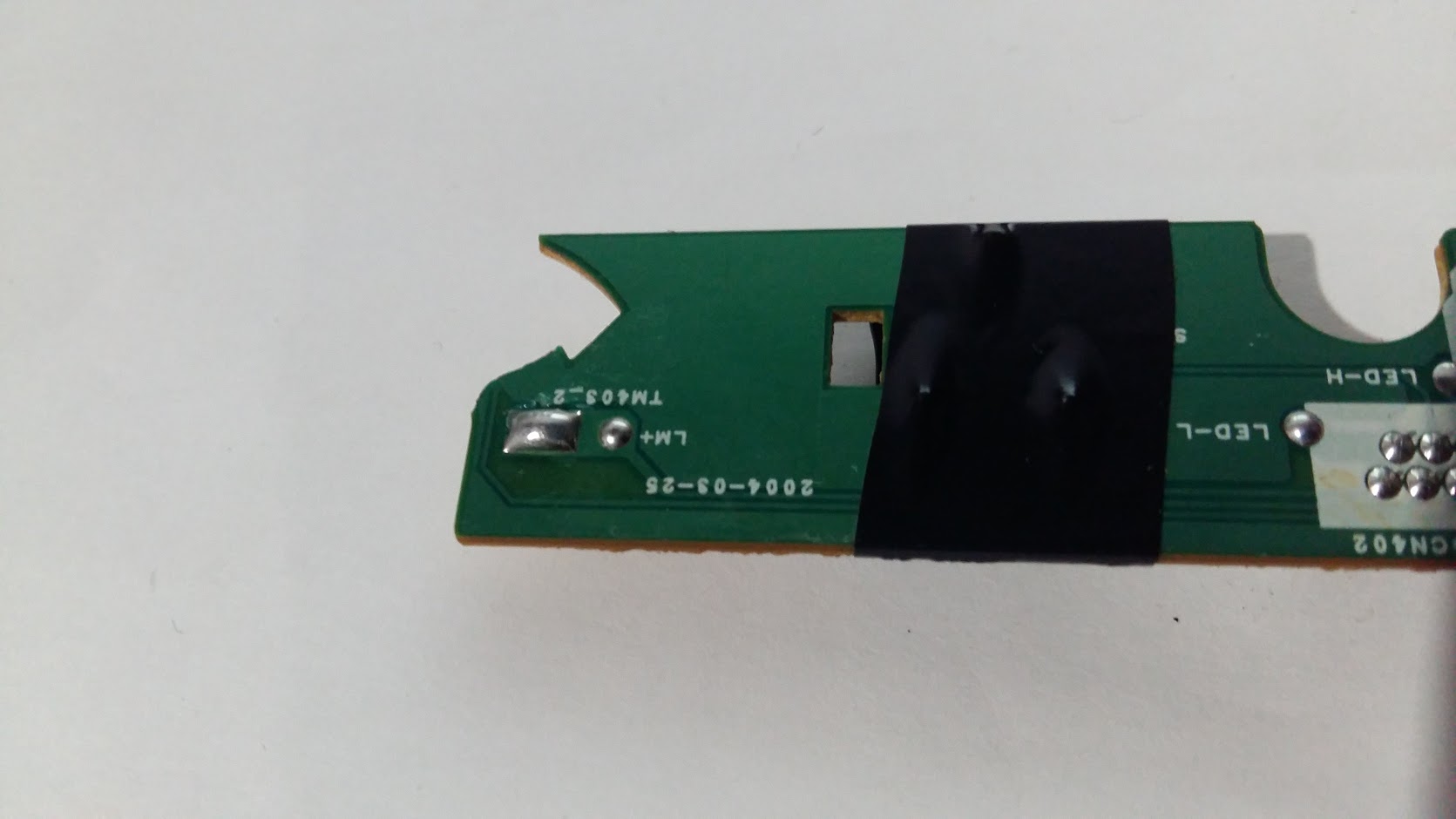

****when i took the board out i accudentally broke the motor side of the board off****** very upset about that (these drives arent that cheap)

im also attaching a photo of that broken pcb my insolence caused
