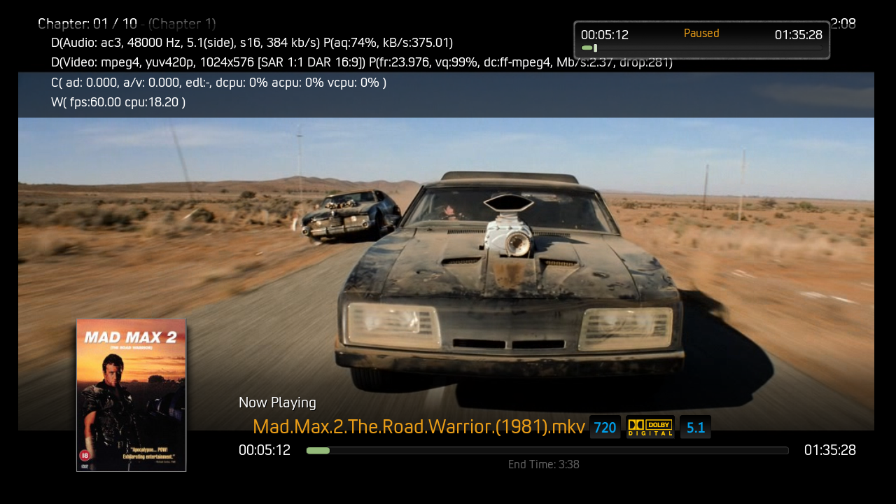

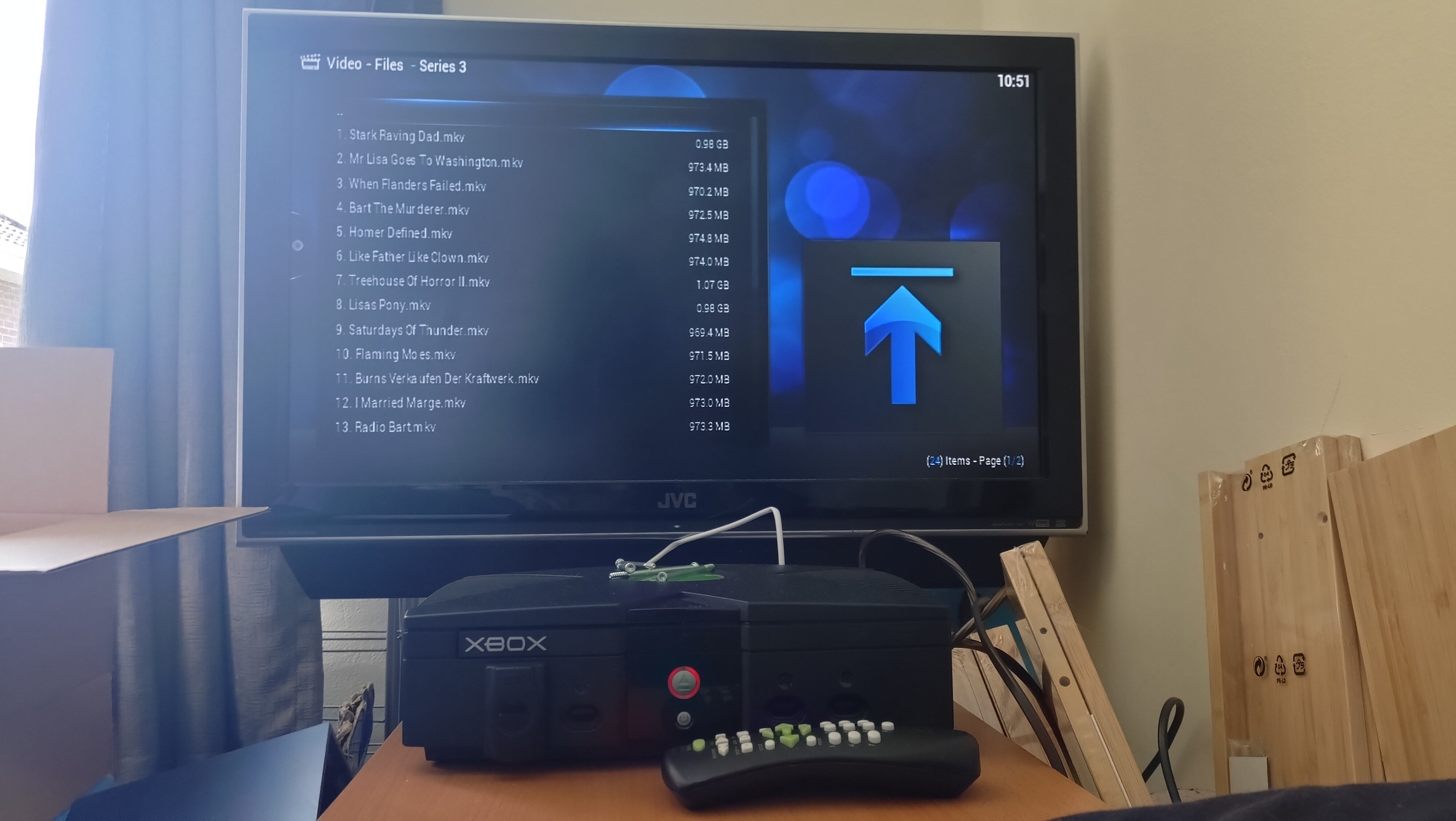

BreadFang Posted May 11 Report Share Posted May 11 Call me old fashioned, but this is still a genuinely good setup to this day. Made a purpose built Xbox setup on my bedroom TV for watching movies in bed. I ripped a bunch of my DVD boxsets and movies 1:1 remux quality and copied them onto the HDD, it plays real nicely with the 128mb RAM. Takes quite a bit of setting up and fine tuning. Screws are still out because I intend on getting a bigger HDD, 500gb wasn't enough. I'll take this over a streaming service or a smart TV any day! 1.4 128mb RAM Cerbios Component cables Modified eeprom to do NTSC at 480p (was originally PAL) This all came about because I did a 128mb mod out of boredom and didn't know what to do with it after the fact lol. In the end it turned out to be a great idea 2 Quote Link to comment Share on other sites More sharing options...

GoTeamScotch Posted June 11 Report Share Posted June 11 Right on! XBMC is still pretty viable for SD and 720p content, even 20 years later. The upcoming version of XBMC, version 4, should be a nice improvement for media library features too. Are you running your Xbox at 720p? It looks like it, but your post only mentions 480p. 1 Quote Link to comment Share on other sites More sharing options...

Bowlsnapper Posted Thursday at 03:46 PM Report Share Posted Thursday at 03:46 PM Can the stock CPU handle 720P in ANY format at all? I would love to put downscaled blu-ray rips on there. DVDs are not true 720. I believe they're 720X480, max. I believe early widescreens were just anamorphic. 1 Quote Link to comment Share on other sites More sharing options...
BreadFang Posted Friday at 07:46 AM Author Report Share Posted Friday at 07:46 AM On 6/11/2025 at 11:21 AM, prtscn said: h264? 1GB is very low for dvds. MPEG2. 1:1 as in it's an exact copy of the discs video file. Not 1GB lol On 6/11/2025 at 7:27 PM, GoTeamScotch said: Are you running your Xbox at 720p? It looks like it, but your post only mentions 480p. 480P over 3rd party component. I would go 720p but the TV in my bedroom is an early flatscreen that doesn't do HD well at all, it looks horrible. I've also heard that running it above 480P can make chunkier video files play worse. 15 hours ago, Bowlsnapper said: Can the stock CPU handle 720P in ANY format at all? I might give it a go. I've only been watching 576p PAL DVD rips as of yet. Quote Link to comment Share on other sites More sharing options...

GoTeamScotch Posted Friday at 08:16 PM Report Share Posted Friday at 08:16 PM (edited) On 6/12/2025 at 8:46 AM, Bowlsnapper said: Can the stock CPU handle 720P in ANY format at all? I would love to put downscaled blu-ray rips on there. DVDs are not true 720. I believe they're 720X480, max. I believe early widescreens were just anamorphic. Sure, it's just a trade-off between resolution and bitrate. 720p on stock CPU and RAM console will get you noticeable macro-blocking artifacts. It's a more crisp image, but there's less information to make up that bigger picture so you see a bit of noise. Some people prefer 480p at higher bitrates and have it be stretched to fill out the screen, which gives a softer image but with less artifacts. Edited Friday at 08:17 PM by GoTeamScotch 1 Quote Link to comment Share on other sites More sharing options...
prtscn Posted Saturday at 03:07 PM Report Share Posted Saturday at 03:07 PM also, discovered that calibration in xbmc is incorrect and is impossible to make it good. Normal video setting in media player. used AVS HD 709 overscan test downscaled to 720p. I couldn't make frame in the video to touch all corner no mater what. Quote Link to comment Share on other sites More sharing options...
