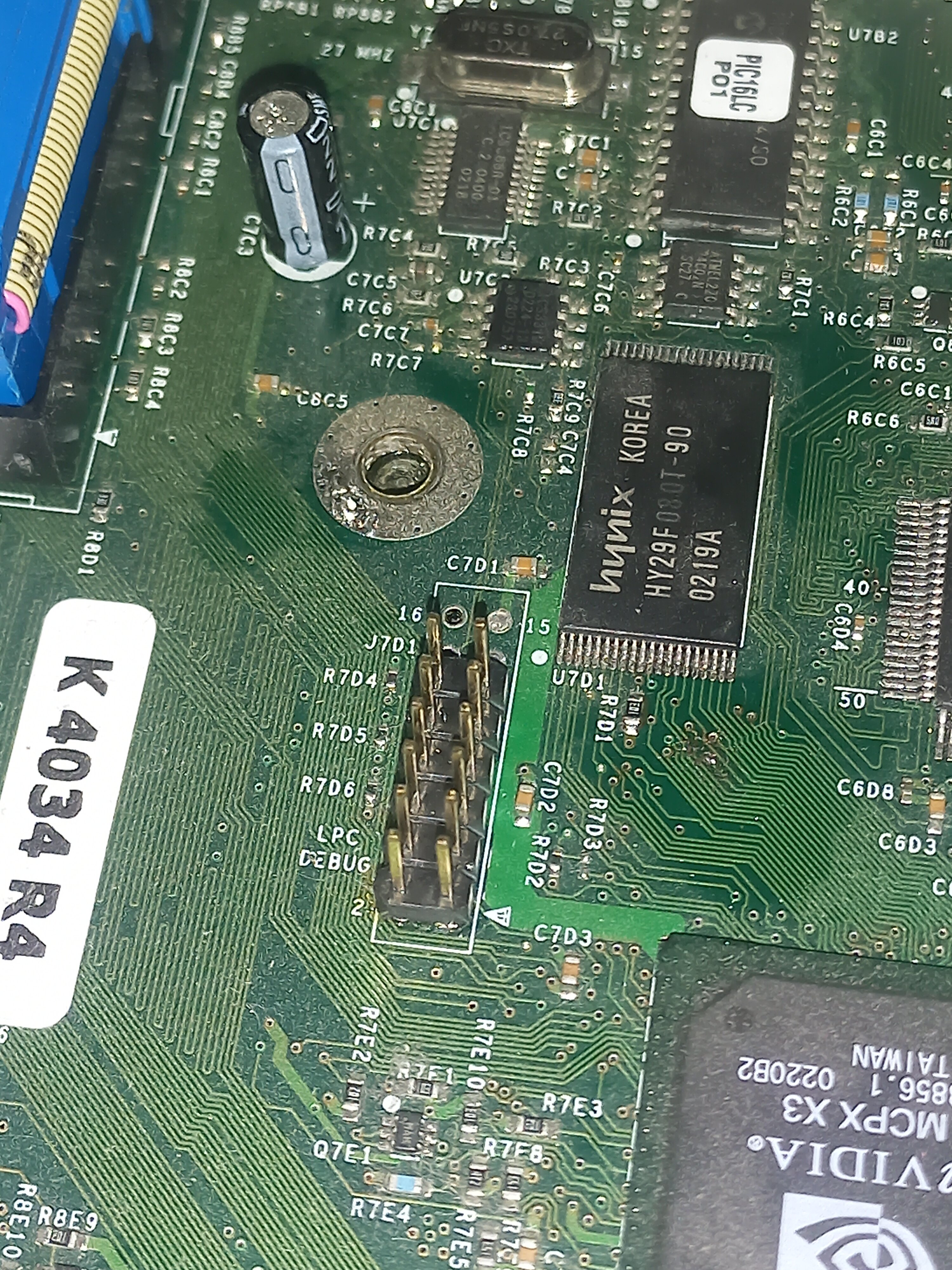

Og v1.0 128 upgraded open xenium
So I have a v1.0 128 upgraded.
Controllers were working no issue on stock dash and cerbios dash when I had my smartxx v3 chip installed.
I switched to open xenium and controllers work fine in xenium os no issues at all.
As soon as I boot into dash I can press any button two times then xbox freezes.
I have switched ports I have switched daughter board.
Same issue plus same on another xenium and a alladdin xt chip.
But xenium os no issue with controllers at all.
Now I did not install the smartxx v3 chip it has lpc header which includes pin 4 somehow.
Could pin 4 installed be the issue causing controller to freeze the xbox in dash?
