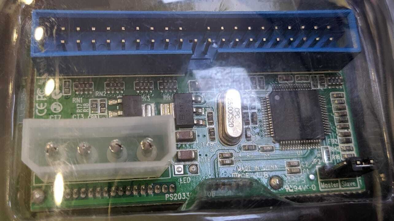

technoob Posted September 3 Report Share Posted September 3 I just found this on ebay. Looks cheap and I wonder if it will work. Quote Link to comment Share on other sites More sharing options...
Bowlsnapper Posted September 3 Report Share Posted September 3 3 hours ago, technoob said: I just found this on ebay. Looks cheap and I wonder if it will work. That looks pretty cool. Although, keep in mind that most cheap adapters max out at UDMA-4 and not 6... sometimes 5 without the DVD-ROM drive present. It depends on the chipset being used. I would use nothing less than a Startech, or at least something sharing the same chipset/controller... although, those will probably be just as expensive. Quote Link to comment Share on other sites More sharing options...
technoob Posted September 4 Author Report Share Posted September 4 1 hour ago, Bowlsnapper said: Although, keep in mind that most cheap adapters max out at UDMA-4 and not 6... sometimes 5 without the DVD-ROM drive present. I honestly don't know what that means. Is it just a matter of speed/performance of the drive (example: I'd get better performance with a startech) or does it mean the SATA drive I want to use won't be recognized (example, during Slayer Evox CD installation...) Just to clarify my needs, it's always been this way: if I plug a PATA drive, the Xbox correctly launches the Slayer Evox installation disc... if I use another cheap adapter I got on Amazon (the green one) with a SATA drive it displays the error page (can't remember which number, something like 13 or 5). All I'd like to know if that adapter (the one on the 1st post) will make the SATA drive recognizable... (I guess only who actually used it can say for sure). Anyway I asked the seller if it's Xbox-compatible and a pic of the rear (since the SATA plug isn't visible), still awaiting response. Quote Link to comment Share on other sites More sharing options...
Marty Posted September 4 Report Share Posted September 4 I'd have to know the chipset this adapter uses. Also, it should have a SLAVE/MASTER jumper on it. Quote Link to comment Share on other sites More sharing options...
Bowlsnapper Posted September 4 Report Share Posted September 4 2 hours ago, technoob said: I honestly don't know what that means. Is it just a matter of speed/performance of the drive (example: I'd get better performance with a startech) or does it mean the SATA drive I want to use won't be recognized (example, during Slayer Evox CD installation...) Just to clarify my needs, it's always been this way: if I plug a PATA drive, the Xbox correctly launches the Slayer Evox installation disc... if I use another cheap adapter I got on Amazon (the green one) with a SATA drive it displays the error page (can't remember which number, something like 13 or 5). All I'd like to know if that adapter (the one on the 1st post) will make the SATA drive recognizable... (I guess only who actually used it can say for sure). Anyway I asked the seller if it's Xbox-compatible and a pic of the rear (since the SATA plug isn't visible), still awaiting response. Theoretically it should, yes. Although your speeds will be more limited, judging by the price. I doubt you'd notice it TOO much, but if you were to do it side by side, you'd see it. If it's just for you and not something you're trying to buy in bulk to turn consoles around, just spend the extra 10 bucks and get a startech, honestly. You'll get good speed and you know it'll work. One time purchase is worth it. Quote Link to comment Share on other sites More sharing options...
UltimateMe Posted September 4 Report Share Posted September 4 You could better look for something like this one, if you want a cheap one: https://www.ebay.com/itm/255483009090?hash=item3b7bf95842:g:ZNAAAOSwQ39iVAVM This one is confirmed working, I use it often for the cheaper mods. The Startech is a bit faster, but more than double the money of this one. Only when using "green" disks it could have some issues, where the Startech is better. Using normal disks the cheaper one is working like a charm. Quote Link to comment Share on other sites More sharing options...

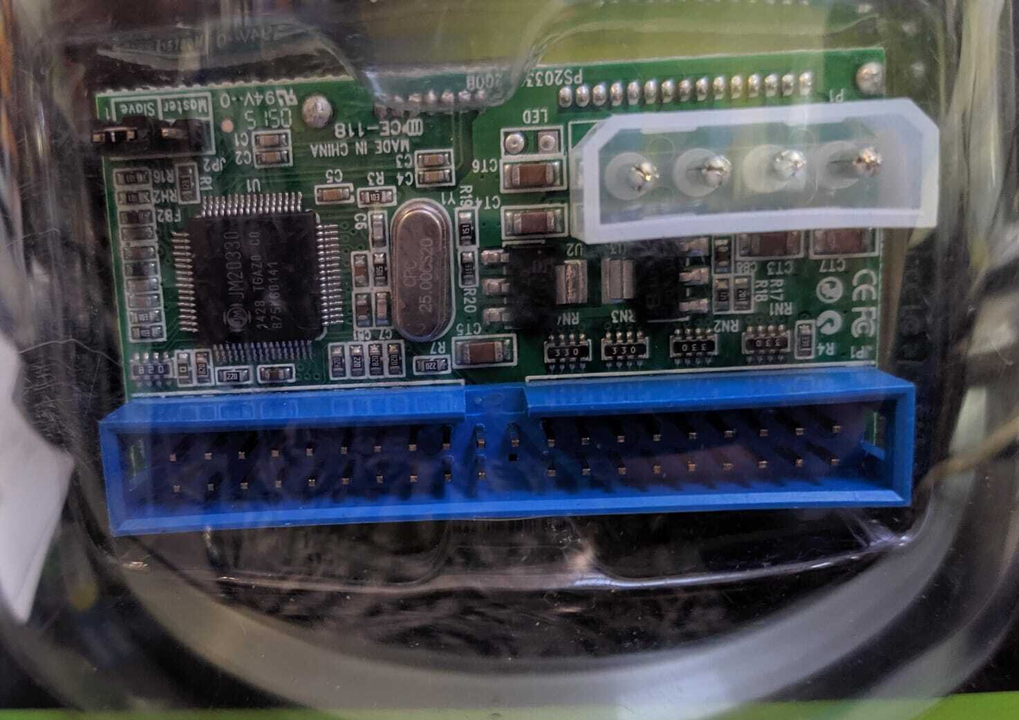

technoob Posted September 4 Author Report Share Posted September 4 (edited) The seller was kind enough to post more pics and specs but the other side of the adapter can't be seen as it can't be extracted from the package. Edited September 4 by technoob 1 Quote Link to comment Share on other sites More sharing options...
tiertop Posted September 5 Report Share Posted September 5 (edited) On 9/3/2023 at 2:22 PM, technoob said: I just found this on ebay. Looks cheap and I wonder if it will work. The Jmicron adapters can work fine. That one appears to be of decent quality. Sometimes the XBox has trouble detecting the drive connected with cheap builds of them though. It can cause a startup delay or may not work at all. Marvell controllers tend to work better. The Xbox runs UDMA 2 (33MB/s) unless you flash a BIOS with UDMA 4 (66) or 5 (100MB/s) support like Cerbios or a M8 Plus Titan mod. This makes the XBox even more picky about drive and adapter. I settled on a SSD at UDMA 2 with standard M8 Plus after lots of experimentation. Edited September 5 by tiertop Quote Link to comment Share on other sites More sharing options...
prtscn Posted September 5 Report Share Posted September 5 On 9/3/2023 at 7:22 PM, technoob said: I just found this on ebay. Looks cheap and I wonder if it will work. Yes, and it should support original ATA cable, since description says that it supports multiple speeds: Compatibile con le specifiche Ultra ATA 133 / 100 / 66 / 33. Quote Link to comment Share on other sites More sharing options...
prtscn Posted September 5 Report Share Posted September 5 (edited) On 9/4/2023 at 12:20 PM, technoob said: The seller was kind enough to post more pics and specs but the other side of the adapter can't be seen as it can't be extracted from the package. BUY IT! [edit]Problem: this adapter can be too tall. and you will no be able to close top lid Edited September 5 by prtscn 1 Quote Link to comment Share on other sites More sharing options...
technoob Posted September 5 Author Report Share Posted September 5 (edited) 5 hours ago, prtscn said: BUY IT! [edit]Problem: this adapter can be too tall. and you will no be able to close top lid It would be a "better problem" than it is now (using two PATA hd that I switch externally). Edited September 5 by technoob Quote Link to comment Share on other sites More sharing options...

Bowlsnapper Posted September 6 Report Share Posted September 6 20 hours ago, tiertop said: The Jmicron adapters can work fine. That one appears to be of decent quality. Sometimes the XBox has trouble detecting the drive connected with cheap builds of them though. It can cause a startup delay or may not work at all. Marvell controllers tend to work better. The Xbox runs UDMA 2 (33MB/s) unless you flash a BIOS with UDMA 4 (66) or 5 (100MB/s) support like Cerbios or a M8 Plus Titan mod. This makes the XBox even more picky about drive and adapter. I settled on a SSD at UDMA 2 with standard M8 Plus after lots of experimentation. An SSD at UDMA2!? Jesus dude... Quote Link to comment Share on other sites More sharing options...
