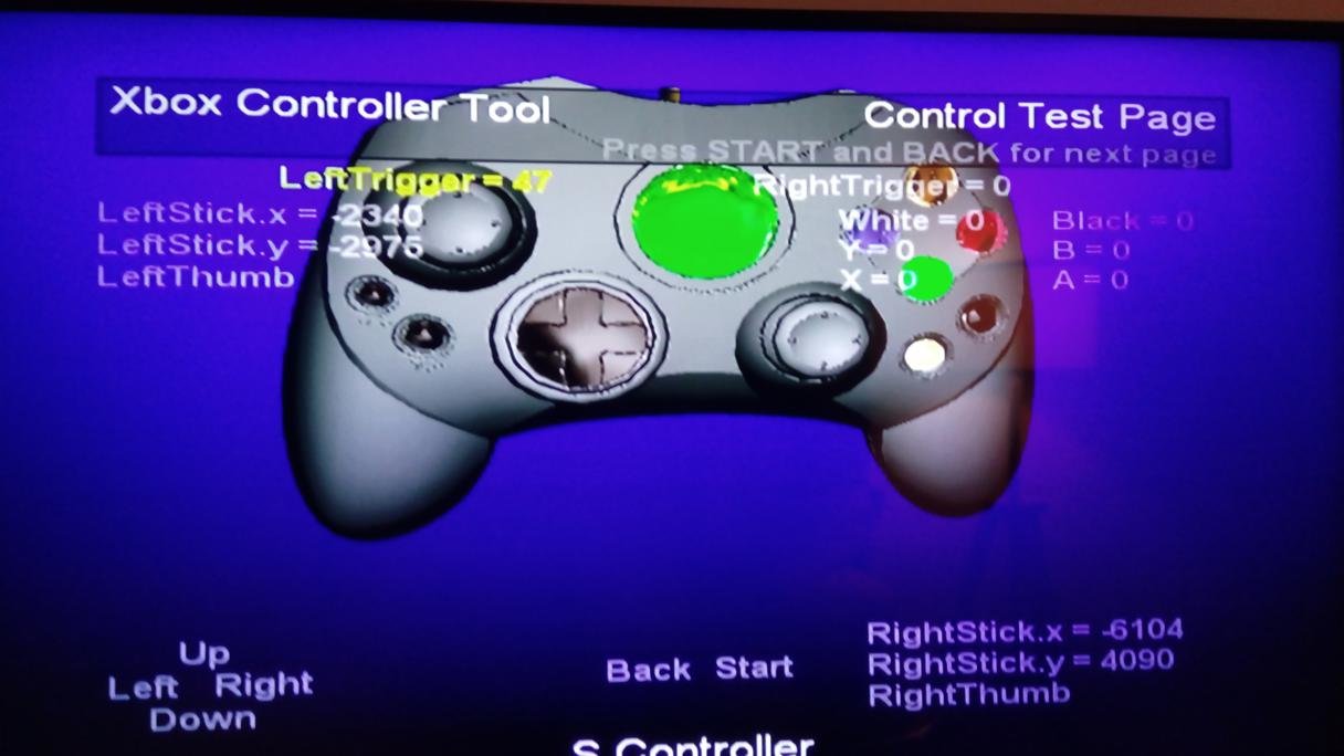

Vespi Posted May 20 Author Report Share Posted May 20 Thanks for the app, I did´t Know and it´s great. After the default firts test Gamepad done, the malfuction seems to be in the LeftStick.x and LeftStick.y, both are moving without touching the control, other buttons with all test works normal, but that no meaning clearly the hardware is the problem? In games do no occurs any with leftsticks. Quote Link to comment Share on other sites More sharing options...
Bowlsnapper Posted May 20 Report Share Posted May 20 2 hours ago, Vespi said: Thanks for the app, I did´t Know and it´s great. After the default firts test Gamepad done, the malfuction seems to be in the LeftStick.x and LeftStick.y, both are moving without touching the control, other buttons with all test works normal, but that no meaning clearly the hardware is the problem? In games do no occurs any with leftsticks. Okay. So you're saying that the thumbsticks are experiencing random inputs but the buttons are not? Quote Link to comment Share on other sites More sharing options...
Vespi Posted May 20 Author Report Share Posted May 20 (edited) Yes, but just the left thumbstick, only in the dashboard or softmodding tool Disk, and any apps too, in games work fine. When unplug it and plug it again the controler fix itself for a while, so let me move for the screen ok until some new load. Do you know if I have to set a cfg file or try something like formated the hdd or any partition? Thanks Edited May 20 by Vespi Quote Link to comment Share on other sites More sharing options...
