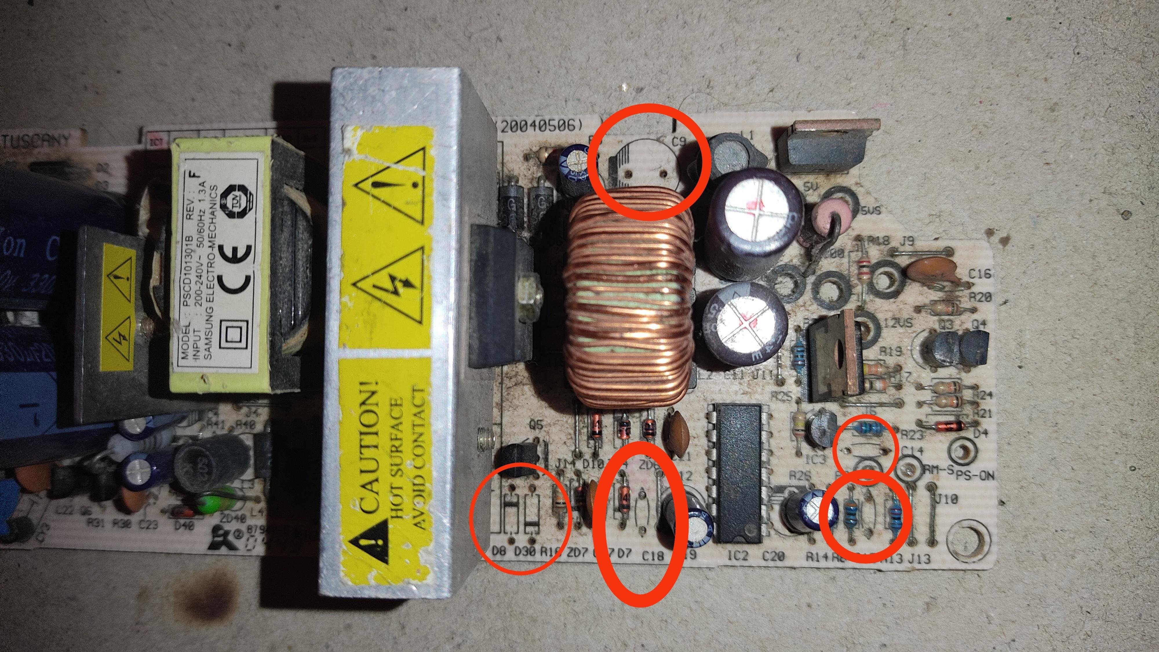

h2player Posted March 16 Report Share Posted March 16 (edited) I have this xbox PSU TUSCANY model but with missing components ,and i wanna repair it Can anyone help me with missing components reference. thnx. Edited March 16 by h2player Quote Link to comment Share on other sites More sharing options...

JohnK33 Posted Friday at 07:15 PM Report Share Posted Friday at 07:15 PM C9 is a 2200 uF 10V Electrolytic Cap, C18 ceramic Cap with 104 on it. C14 ceramic Cap with 104 on it. D8 and D30 look to be the same as D40 C15 ceramic Cap with 103 on it. Quote Link to comment Share on other sites More sharing options...
h2player Posted Saturday at 06:15 PM Author Report Share Posted Saturday at 06:15 PM Thnx a lot man for info I will try now to fix it,i will post update. Quote Link to comment Share on other sites More sharing options...
