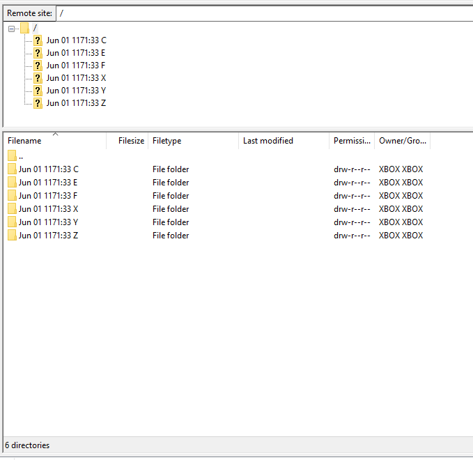

Hello, I was wondering if anyone else has encountered this issue? I have an Xbox console v1.6 with an xecuter3 CE chip in it. I have formatted the drive using the x3 bios utility, and transfered over UnleashX v0.39 to the C drive. It does boot into UnleashX, but when I try to FTP files to it using FileZilla,  the directories seem to be named weird with the date in front of them. So fileZilla tells me that the directory is not found... I have attached a screenshot. Please let me know what you think, it is much appreciated!
Yes there's a problem in official release of UnleashX 0.39.0528A Build 584.  The previous version 0.39.0222A Build 572 does not exhibit this problem.
I also think that if you use Build 584 as an application run from XBMC after letting that dashboard set the time/date UnleashX Build 584 doesn't have that problem either.  It's just when UnleashX uses NTP to set the time from the Internet that the problem occurs.
