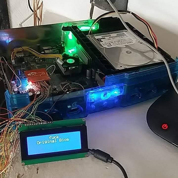

  2. OK Leute ich fange heute an Bilder zu Posten Das ganze wird in einer OGXbox 1.1 verbaut LG GDR-8163B Smartxx v3 mit lcd 2004 Tsop Split 2x 512kb Und dazu das xtender Kit OK guys I'm starting to post pictures today The whole thing is built into an OGXbox 1.1 LG GDR-8163B Smartxx v3 with lcd 2004 Tsop split 2x 512kb And the xtender kit https://imgur.com/gallery/YpABAKq

  4. I'll be posting pictures by the end of this week. The kit works too I didn't say that it doesn't work for me it was interesting to know whether this function really exists because it can be read on the page
