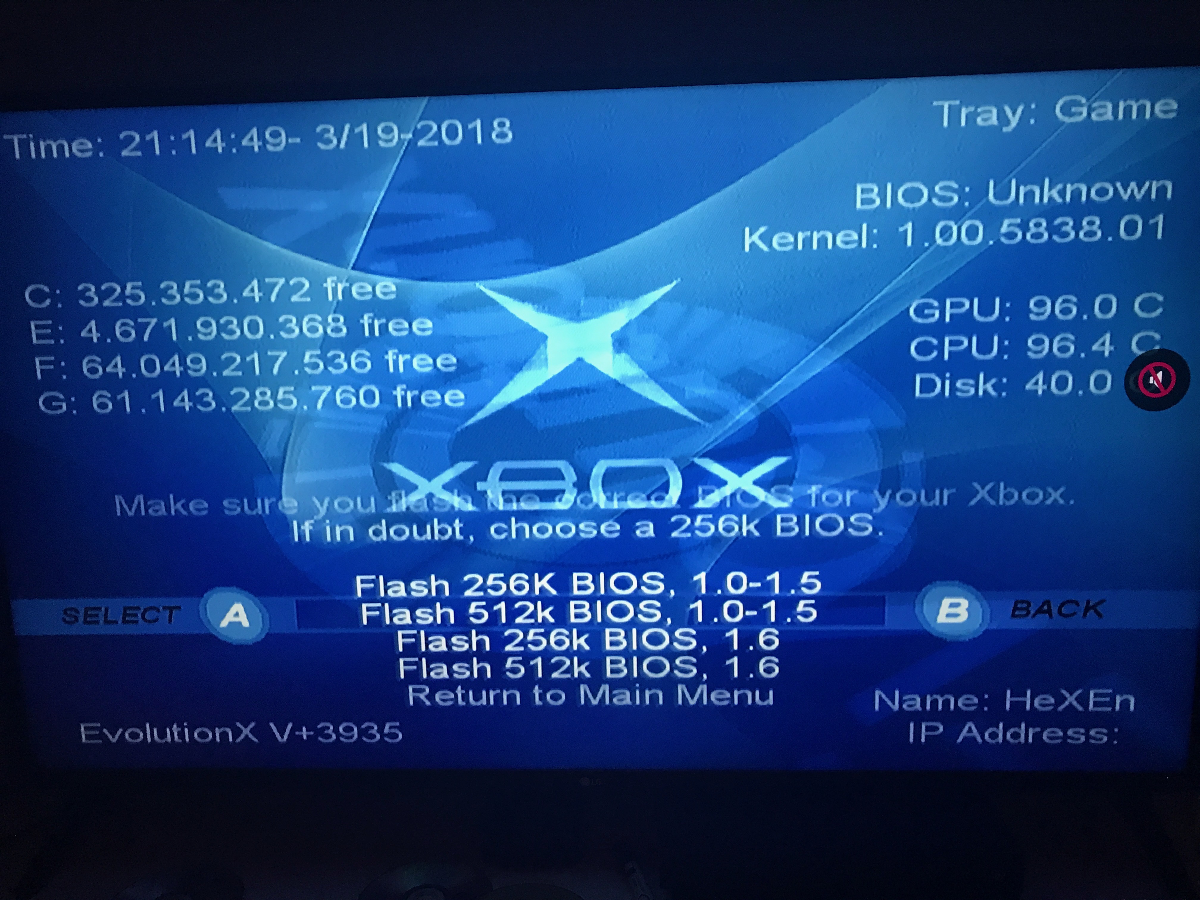

I just got an 1.6 Xbox with a DuoX2 Lite modchip.
Can someone tell me how i can identify the bios flashed to the chip?
And can i flash any bios to the chip with Hexen 2017?
I bought the Xbox 10 yrs ago, so i am wondered if there would be any advantages for updating the bios to a newer one than the one thats on there now?
im pretty sure that the flash menu in hexen lists the current bios (top right corner). i cant help with pros/cons of newer bios. ive ever tried any other than evoxm8+ on 1.6
In the Hexen Flash menu it says Unknown. Could you tell me if my installed games disappears if i flash the bios and format the c: drive to install unleash x dash?
interesting.
i wont advise you do anything until we dissect this a little further. at work. will follow-up if noone has later on.
Ok. I wont do anything for now.
I am newb to xbox modding, so i only want to flash and reinstall to learn something. But the only thing i figured out for myself is that i have a duox2 lite chip installed :P
Thank you for your help wikati.
The BIOS is unknown as there's NO MD5 hash in the config file to ID it (one has to know which BIOS they were working with and keep track of the MD5 hash and add it after making changes to the official BIOS release).  But, as the Kernel is 1.00.5838.01 then it's an M8plus BIOS [update: or M8] (or stock MS BIOS - but as it's running unsigned code can't be so M8plus it must be).  The latest BIOS available for a v1.6 Xbox.  There have not been any newer BIOS releases.
Evox M8plus based on MS 5838 Kernel.  They should have changed the version number a bit but no.
Update: May be Evox M8 as it too is based on MS kernel 5838.
Only other BIOS that will work on a v1.6 is the X2 5035 16 version (512KB in size). If the Duox2 Lite has a 512k Bank you could try it. It's configuration is read from a file e:\x2config.ini.  Edit the file and you can change flubber and logo colors without needing to reflash the BIOS.
